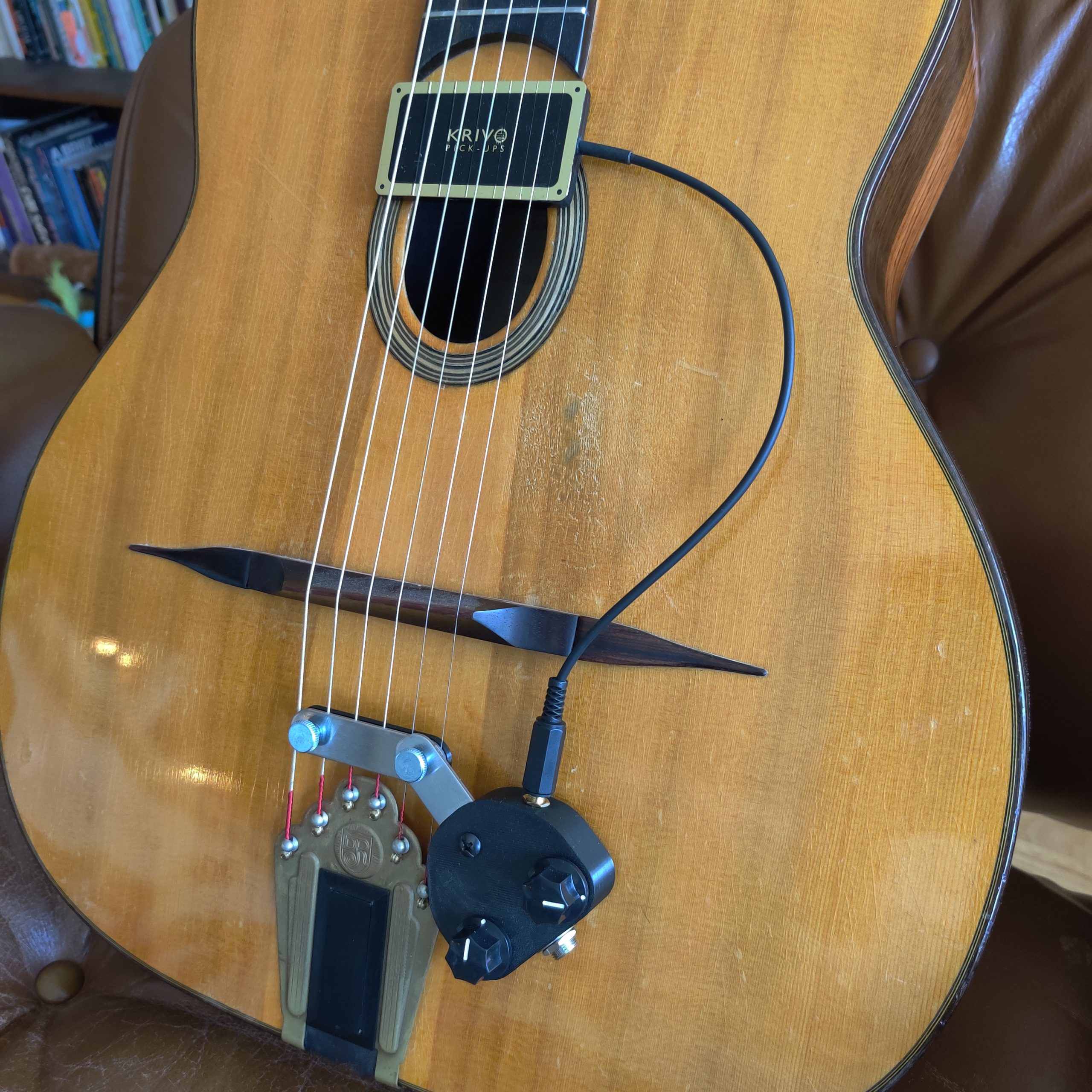

    Re volume control, @vdub builds them, volume only or volume/tone. But they're easy to build yourself too.

    You could, run a short cable from the output jack of LC (if the output jack is mounted on the tailpiece) to the input on the volume control box. Pictures on his site show it with 1/8" mini input and also hardwired so I'd check with Vic about the options. Since the LC pickup is meant to have its jack mounted on the tailpiece hole, I'd imagine you could skip that and take its cable outside of the soundhole and to the volume control, just like pictures show with the Krivo and DeArmond.

    The pins on the LC would need to be cut and an 1/8" added in place but that wouldn't be a challenge. Might not look the best though, the wire coming off the pickup would need to be spliced to add length.
