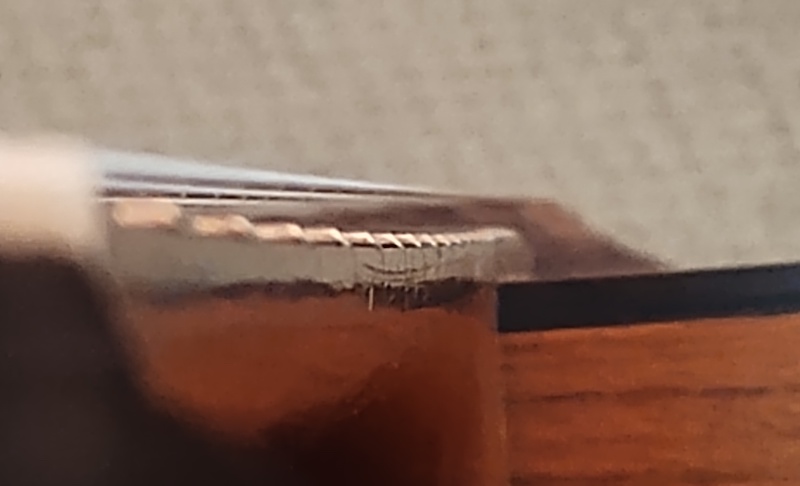

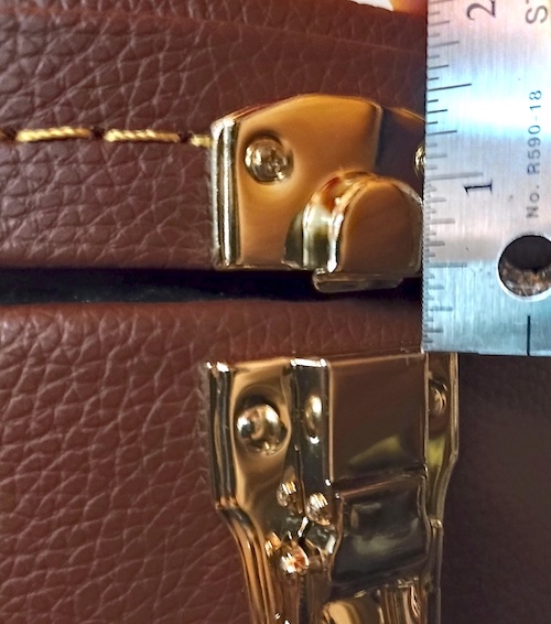

I recently bought a Cigano GJ-10 in order to get into the world of Gypsy jazz. It didn't come with a case but today I found a Superior Deluxe Gypsy Jazz Case (Brown) for a good price...new. Shape-wise, the guitar fits in the case very snugly but properly; no shifting around, that's for sure. The problem is when I close the top it presses against the bridge. If i just let the top sit naturally there is about a 1/4" gap between the lid and case body. In order to actually clasp the top closed I have to push the top down for the latches to meet. There seems to be a lot of pressure pushing down on the bridge and it worries me that something is going to give: the bracing, crack the top etc...

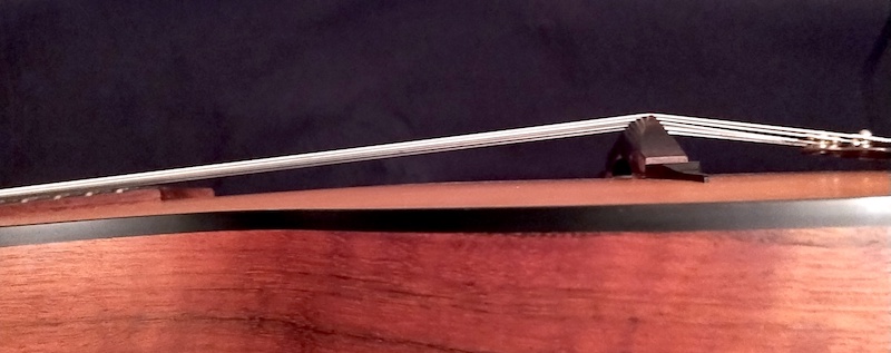

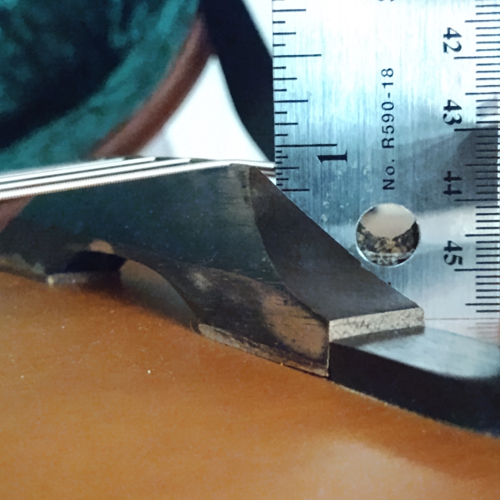

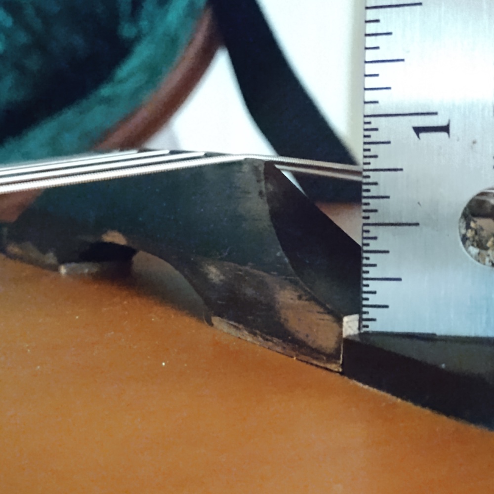

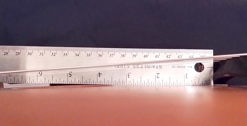

  • Wow murrayatuptowngaller, thanks for the fantastic response. I just finished measuring my guitar and the dimensions are similar to yours: body thickness around 4.5" and the bridge about 1" high...5.5" (14cm) thick. The current case interior is about 5" high without compression the foam. I don't know how Cigano says that this is the hardcase for this guitar. I can't help but think that the guitar is somehow not right in the body. The back has an arch and the top has an arch along with the high bridge. And I thought my Gretsch had a high bridge!
