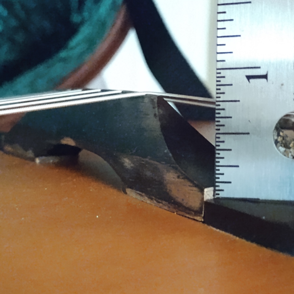

I recently bought a Cigano GJ-10 in order to get into the world of Gypsy jazz. It didn't come with a case but today I found a Superior Deluxe Gypsy Jazz Case (Brown) for a good price...new. Shape-wise, the guitar fits in the case very snugly but properly; no shifting around, that's for sure. The problem is when I close the top it presses against the bridge. If i just let the top sit naturally there is about a 1/4" gap between the lid and case body. In order to actually clasp the top closed I have to push the top down for the latches to meet. There seems to be a lot of pressure pushing down on the bridge and it worries me that something is going to give: the bracing, crack the top etc...

    Wow murrayatuptowngaller, thanks for the fantastic response. I just finished measuring my guitar and the dimensions are similar to yours: body thickness around 4.5" and the bridge about 1" high...5.5" (14cm) thick. The current case interior is about 5" high without compression the foam. I don't know how Cigano says that this is the hardcase for this guitar. I can't help but think that the guitar is somehow not right in the body. The back has an arch and the top has an arch along with the high bridge. And I thought my Gretsch had a high bridge!

    Did you buy the Cigano new or used? If it’s used, it’s possible someone changed the bridge - that used to be pretty standard advice to Cigano owners as a cheap upgrade. I got a new bridge for my Cigano but didn’t end up using it as it was about twice the height of the original one.

    I got the guitar used. I don't think it was ever stored in a case but it's actually in good condition. The high "E" (and sometimes the "B") fretted out on 12th fret when I first got it. I've been humidifying it and that has sorted it out mostly. The bridge is pretty shabby looking and has definitely been shimmed probably to sort out the neck/body joint hump. Even so, the issue is that the case is 1/2" too shallow. The Hiscox case looks great but I'll keep that investment for when I have a better guitar.
