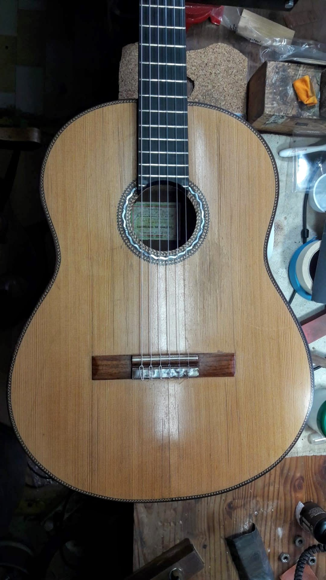

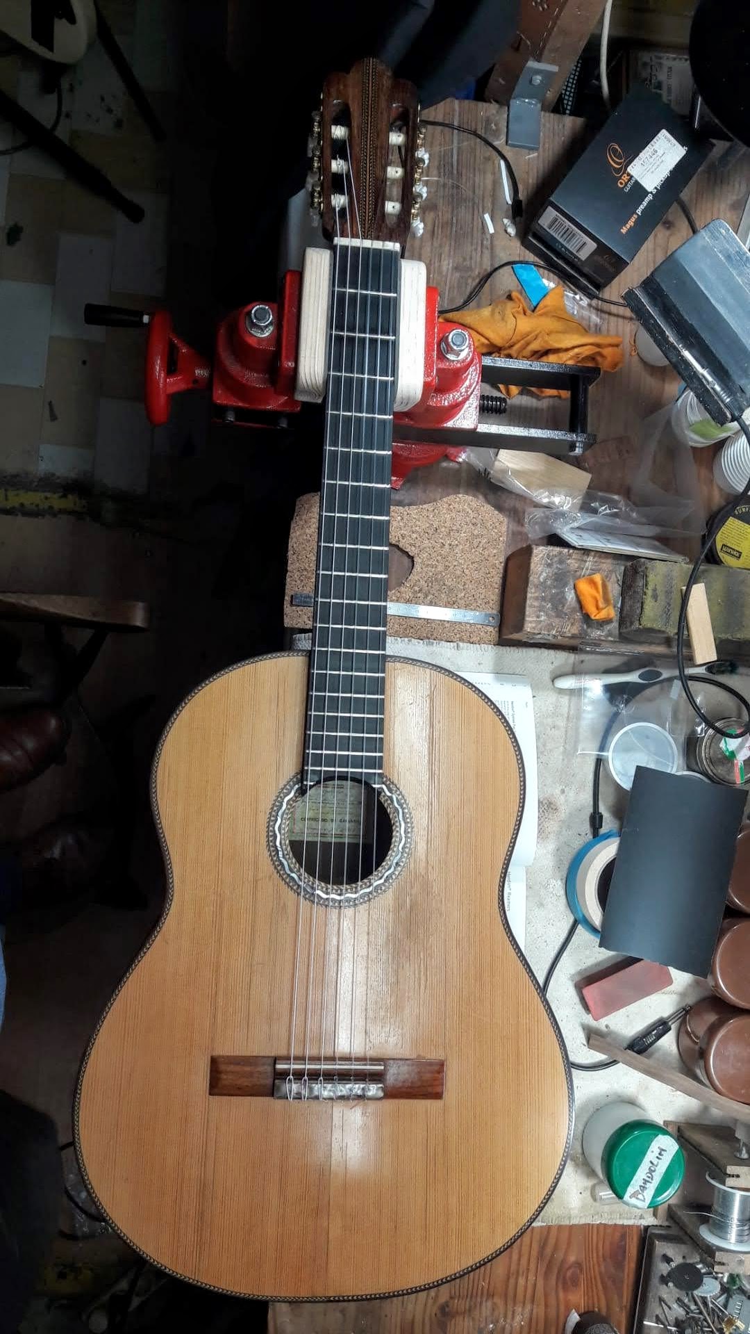

     Talked with luthier Vitor Paulo this week and these were his comments:
     Although steel string violas de fado are common, accompanists in fado groups may alternatively play a classical nylon string. These would be strung so as to provide higher tension than used by classical players;
    The steel string violas have a stronger construction to allow for higher tension: traditionally with a steel rod in the neck, though many use a carbon fibre rod today;
    The lower priced models may not be a good choice - pro models tend to be in the 3000 to 4000 € range
    Top thickness is similar to that of classical guitars.
    He was working on a 1980s viola de fado (pictured) as we spoke, its currently
    strung with nylon strings, and on having had a look at the bracing he reports that its similar to that of classical guitars.

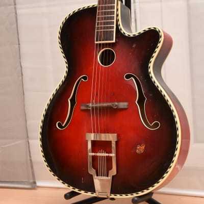

    The Hüttl in fact is a Pique Dame model, which was produced in the 50ies and 60ies.
    Most pictures of Pique Dames that I found in the internet show them with this type of tailpiece:
    But there is a catalogue picture that shows that the tailpiece of the fleamarket Hüttl should be original:
    http://www.schlaggitarren.de/home.php?text=hersteller&kenn=68

    I recall that the Pique Dame was one of the fanciest of the Huttl range.
    Willie, do you recall how much they were asking for this one? I like the Black Rose finish.

    Another vote for the Huttl here. I have never caught one yet, obviously rare in Australia, I will have to buy from Europe, but yes, a lot of the fancier German archtops look best in the Black Rose finish. As for the tailpiece, I wouldn't worry, as with other brands they often changed, I think both of these types were made by a separate supplier, they are often seen on Hofner, Hoyer etc and maybe they simply used whatever was in stock? I had one similar on a Hoyer I sold recently.
